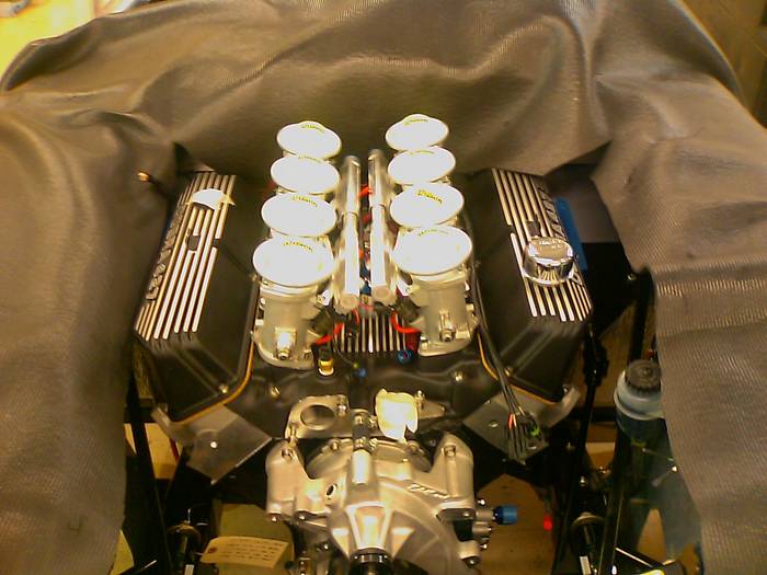

You have to love this web site. Here is a picture of my set up...normal TWM setup except I had the manifold powder coated to match my valve covers...
Two thoughts...
1) I have only talked with AL at Thorconst...but he seems to really know what he is talking about. I just wished he lived closer to me.
2) My only complaint is the BB FE set up has left me in need of air cleaners....I keep hearing about something coming but I think I am going to have make my own....if anyone has done this before, I sure would appreciate any feedback.

Forgot that pic kinda sucks...here is one of the setup in the car....
Pardon the tennis balls....still working on fabing up some cool filters (They have a "air box" that covers them all up but I love the individual stack look)
