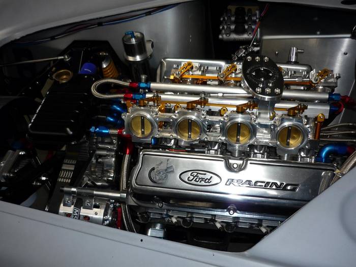

Keith Craft is a pretty good source for an EFI setup if you are doing an engine from scratch. I would recommend the TWM setup with a FAST computer. You might also look at FAST's new electronnic traction control option. I'm going to try this on my ERA. Also, FAST has just started offering a dual-sync distributor for the FE engines. This allows individual cyclinder correction of fuel and timing to get the best possible tune. Attached are a few pics of the engine the Keith Craft did for me. More pics of the engine and the rest of the project can be found in my gallery.
- Fred
http://www.clubcobra.com/photopost/d.../Engine_05.jpg
http://www.clubcobra.com/photopost/d.../Engine_01.jpg
I've gotten some interest from several folks on this forum on the Electronnic traction Control setup that I'm installing on my ERA Cobra so I thought I'd post an update. The ETC system is based on the latest version of the FAST XFI ECU. The system uses a driveshaft speed sensor (picturedbelow) to allow the EFI computer to detect when the rear wheels begin to speed. When this happens, the ECU retards the ignition timing which reduces the motor's torque output and controls the spin.
http://www.clubcobra.com/photopost/d...t_Sensor_1.jpg
The driveshaft sensor is a custom made part. ERA, a local machinst, and I collaborated to modifity a standard FAST driveshaft sensor to create the custom setup for my ERA cobra. I'm anxious to see how this setup will perform.

I am preparing to install my engine in my cobra an I needed to remove the IAC assembly to re-orient it and to polish the chamber cover. I thought I'd post a few pictures for the IAC air block and plumbing under my TWM intake. As you can see, there is a distribution block just below where the rear intake breather would go on the TWM intake for my FE. A line runs from this block to each intake runner on the the TWM manifold.
http://www.clubcobra.com/photopost/d...dium/IAC_2.JPG
Here's a picture of the inside of the intake ports - you can see the fittings where the IAC plumbing connects to the ports.
http://www.clubcobra.com/photopost/d...s_to_Ports.JPG
The following shows the IAC and cover reinstalled on the TWM intake. A 90 degree fitting and a custom made aluminum cover allow the IAC motor to mount neatly on the the back of the TWM intake.
http://www.clubcobra.com/photopost/d...C_Detail_1.JPG
With this setup, my FAST XFI computer can regulate the idle speed of the motor my allowing a controlled amount of air into the cyclinders at idle.
