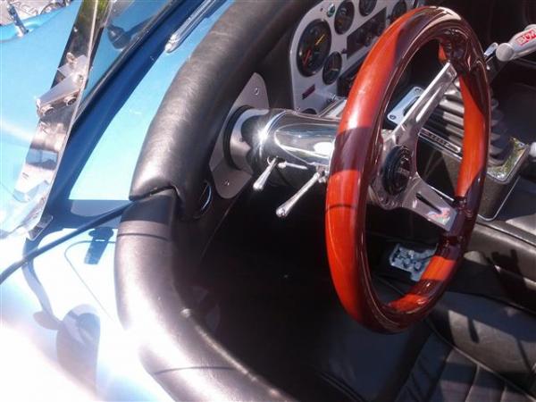

BOBOCobra
Yep, already done. Put column through firewall a few inches and took off the "steering box" that is screwed into the firewall, no need for it. Fiberglass modifications required but trimmed it out nice. Actually I have more room for plug #4 without that box and he dropped shaft lower. Prior installation had the shaft swivel rubbing on the the front head bolt, terrible installation. Trimmed out dash to match aluminum dash panel. I will post some pictures. Raining today, not good light. Darryl did a great job.

BOBOCobra
Here you go. No problems with fit. Wheel is a little smaller but thicker and I like it.
