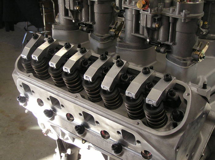

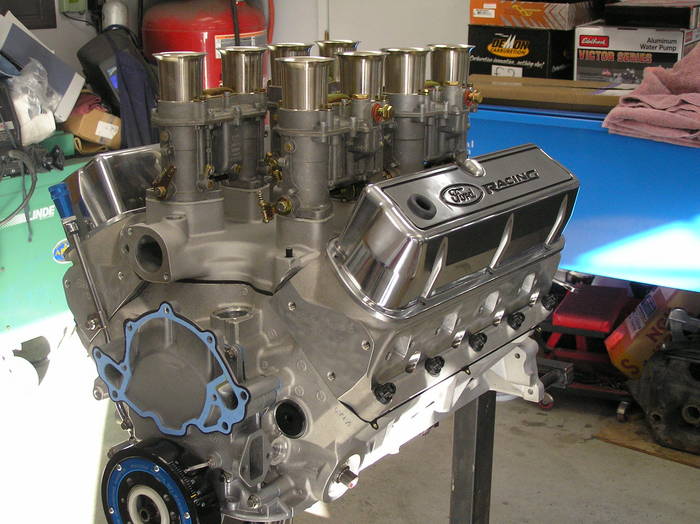

Tony Ripepi 01-05-2007 10:47 AM
Thanks for the replies,
Here are two pics of my engine.
http://www.clubcobra.com/photopost/d...Engine_003.jpg
Roller Rockers wo valve covers
http://www.clubcobra.com/photopost/d...Engine_005.jpg
With Ford Motor Sport Polished Aluminum Valve covers

Tony Ripepi 01-05-2007 02:30 PM
Thanks Jim,
I like the look the issue now is will they fit on my engine with the roller rockers.
TR

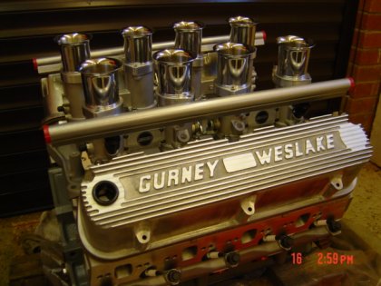

Chris Melia 01-06-2007 08:45 AM
Gurney Weslake covers
Hi guys
my valve cover fit the Small block Ford heads and will clear roller rockers, I have sold many sets to GT40 owners without problem.
People that have exotic valve gear or extra high lift cams above 1/2" may need to do some machining.
http://www.gt40s.com/forum/attachmen...1&d=1116662567
regards
Chris Melia.
