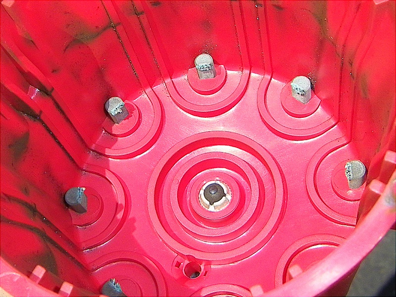

Does any one have a good picture of the center tab on the inside of the cap.
I thought I could save some time by not pulling the distributor, I can check the gear while I have it out. Is there any one local that caries the msd pick ups?.
patrickt 04-10-2013 04:34 AM
Here you go. This cap had about 3,000 miles on her, IIRC.
http://www.clubcobra.com/photopost/d...usedcap001.jpg
wrench87 04-10-2013 05:21 AM
After seeing your picture mine is worn, how do the stock chevorlet caps hold out?. Does any one have a part number for a aftermarket cap?
