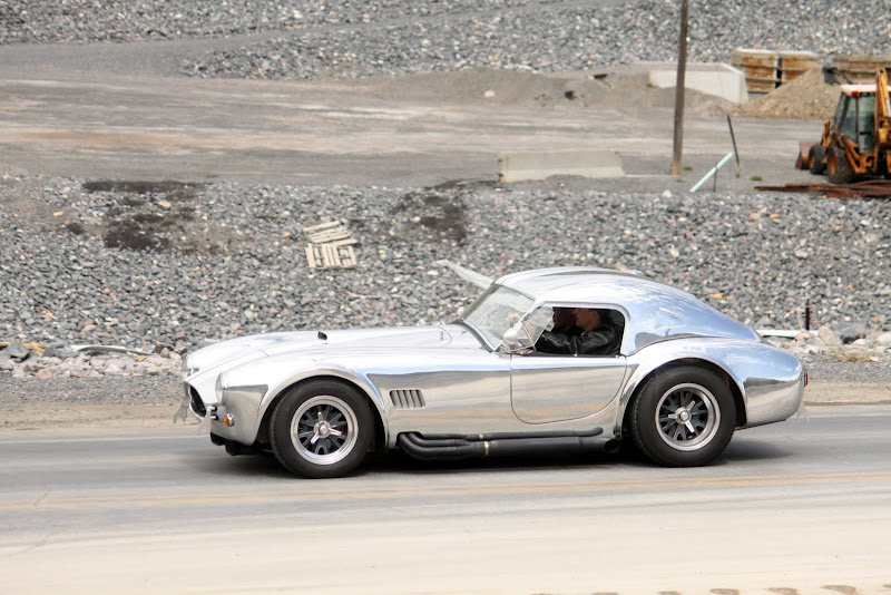

I have a leaf spring 289, KMPS033. What specific questions do you have? Feel free to PM me.
henryr 05-09-2010 07:15 AM
2 Attachment(s)
i hate threads without pics....
Swanny80 05-09-2010 10:48 AM
3 Attachment(s)
Does this reduce your hatred?
