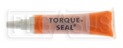

IndyCobra 06-22-2010 07:28 AM
Originally Posted by RestoCreations (Post 1057250)
-I have some paint that i use to mark the bolts. Its a great idea and thanks for the reminder.
http://www.pegasusautoracing.com/Images/L/3329.JPG
There's a product called Torque Seal for marking hardware if interested. It can be had in a multitude of colors.
