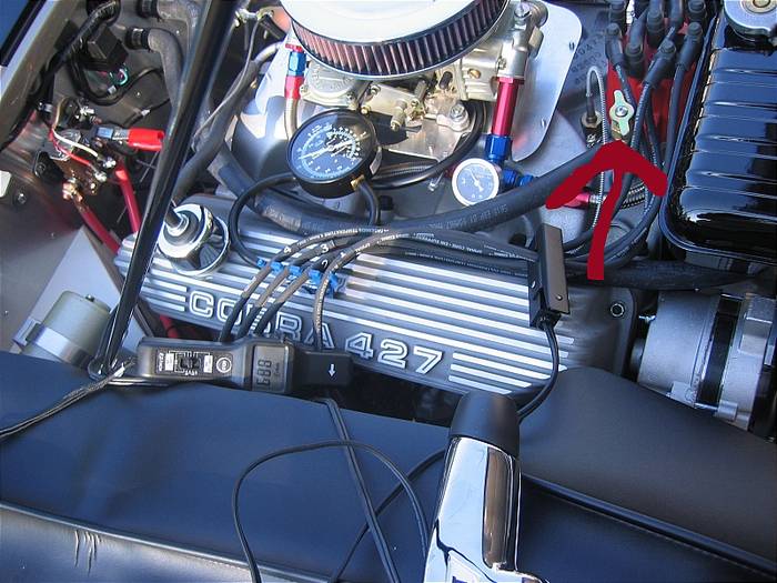

Water temp sensor? Almost always on the front of the intake manifold right behind the heater hose outlet (which the red arrow points to in this pic of mine).

The water temp sensor goes into the intake manifold right behind the thermostat. The oil temp sensor goes in the oil pan.
