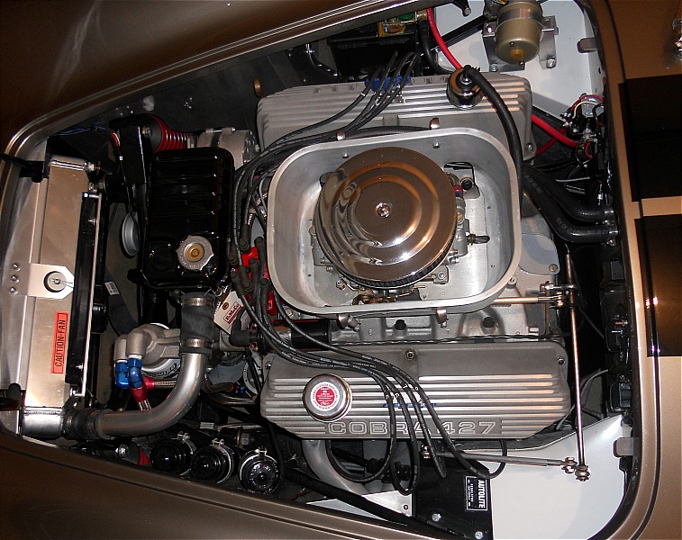

Ahhh, Rick Parker recommends these guys: http://www.burnsstainless.com/tubingmain.aspx Apparently there have been threads on here with guys having problems with crappy connecting tubes.

The tube goes from 2" at the expansion tank to 1-3/4" at the radiator.
That's interesting. I bet I've looked at that tube a thousand times and never noticed that before.

Posts: 5,499
You can see it in your pic where the clamp is cinched down at the tube end. It's hard to notice with your incorrect CLR tube ;-)

Burns will expand the ends for $7.00 per expansion,not sure how far the stainless can be stretched (? anyone know?). An option I have used is getting a section of a radiator hose that is shaped correctly an steps up a 1/4". IE: from 1 3/4 to 2" OD. There is one on the lower metal tube here that has the above dimensions. The upper hose changes 1/4" also but in a longer length of hose.
[IMG][/IMG]
