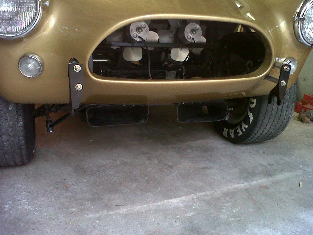

1985 CCX 10-12-2012 01:46 PM
I have two many fans............. :o
http://www.clubcobra.com/forums/pict...pictureid=8736
KevinW 10-12-2012 02:33 PM
Jeff's fans look the same as mine, from Finishline.
The blades are ali - Im polishing them up at the moment - I know it aint original, but I cant help myself. If I see ali, i got to polish - luckily I cant afford a Kirkham (geddit?) ;)
Seems most people think a semi-gloss black is right for the motors, which agrees with the very limited number of pics i can find of original cars with thos on show... so thats what they'll be.
