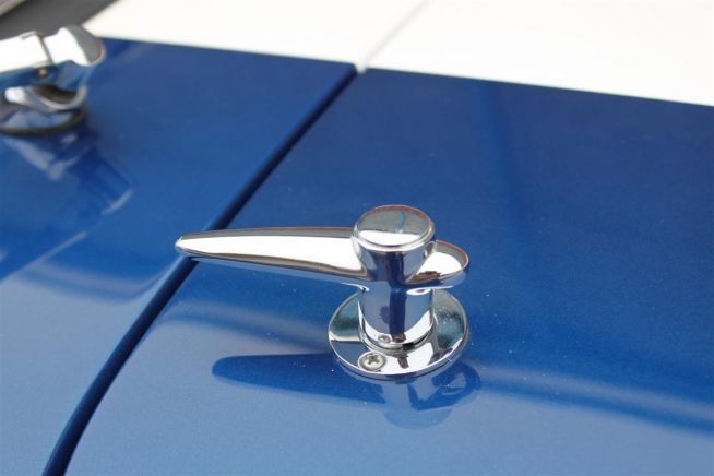

Clayboy 11-30-2012 03:13 PM
Steve,
A picture is worth a thousand words... is this the original style that you are talking about?
Bob
http://www.clubcobra.com/forums/pict...pictureid=8985

KevinW 12-01-2012 01:31 AM
Originally Posted by Clayboy (Post 1220988)
Steve,
Bob
thats what mine look like!
Clayboy 12-01-2012 10:46 AM
Thanks KevinW,
To clarify, you ordered them separately from Hawk Cars for your Crendon? Did the "eye" shaped ones come with your car originally?
Bob

KevinW 12-11-2012 06:38 AM
Hi guys, sorry I missed this thread.
I am not at home tonight, but happy to take a measurement and post up if you can wait a few days.
being an anorak, I noticed that most replicas have the eye-shaped base, and most CSX cars have the round base. So when I ordered my crendon, i got Hawk to supply the bonnet klacthes which i then forwarded on to John Kerr at Crendon when he was building up my kit. He then fitted these for me.
It maybe wortgh adding that i think original ali bodied cars have a budget lock under each latch, rather than the tongue or lobe often attached to the latch shaft used on replicas. My car has the usual lobe to secure the bonnet in the closed position.
Kevin
Clayboy 12-11-2012 09:05 AM
Kevin,
Steve and I are also anoraks, so it's all good. LOL
I received an email from Gerry at Hawk this morning and he states that the "Base OD is about 1 3/8". What he didn't answer was my question about the diameter of the mounting holes, which is critical to making an easy change from one style to another. If you could provide that information it would be very helpful
Bob

KevinW 12-30-2012 04:18 PM
Sorry for the tardy response on this, others have probably answered already, I remember Gerry muttering something to me about original latches being hard to get hold off, but i cant remember if he makes these up or if they are OEM items - Im sure he'd be happy to talk to others. But for the record,
on my latches (which came from Gerry Hawkridge at Hawk Cars):
the base is 36.2mm diameter (approx 1.42 inches);
the external diameter of the handle shaft is 18.6mm (0.72 inches);
the distance between the two screw holes in the base is approx 27.2mm - this is only accurate to about a mm or so, as i measured this between the centre of the crosses on the cross-head screws.
Any other measurements, let me know, as I'm relaxing/working on the cobra project now before going back to salaried stress in a week or so.
