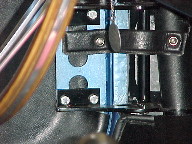

my427cobra 06-10-2013 10:23 AM
Hi Rick. I posted this pic in another thread talking about the door pocket.
This pic shows the door limit/stop strap connected at the hinge end between the two hinge "legs".
I know Cobra Restorers sells them and maybe others do also.

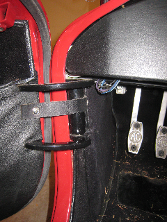

my427cobra 06-10-2013 10:45 AM
Here are a couple more pics but I don't know if they are "restoration correct".
http://www.clubcobra.com/photopost/d...door_strap.jpg
http://www.clubcobra.com/photopost/d...or_strap_2.jpg

mickmate 08-29-2013 05:53 PM
The door hinge limit straps are vinyl to match the dash and wrap on cowl hoop etc. I describe them here.
Door Hinge Limit Strap [427 289 CSX CCX KMP ACE HT SPF] - $40.00 : Acton Custom Enterprises, Custom Metal for Cobras
