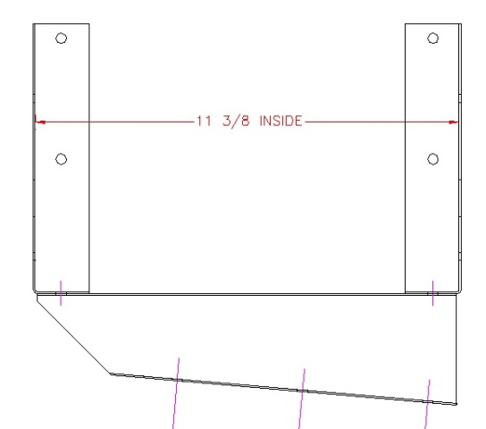

AC Cars Ltd supplied the battery mounting bracket and the piece of British specification marine plywood that fit inside the bottom (same plywood used as a gap filler between upper and middle fire wall panels at their overlap joint). The holder was nominally 11-3/8” wide inside side to side. Functional width was a little less because the Cobra unique J-bolts for the top channel clamp fit on the inside the holder’s side walls. Not shown in the sketch below is the deformation required for the hole in the side wall on the engine side that the holding clamp j-bolt on that side must hook into. As drawn it is for CSX2xxx chassis with battery ahead of the right side footbox. Deforming the hole opening is required because the battery heat shield assembly is attached to the engine side wall of the bracket. The deformation must be pronounced enough for the bolt hook to fit in.
http://www.clubcobra.com/photopost/d...tey_Holder.jpg

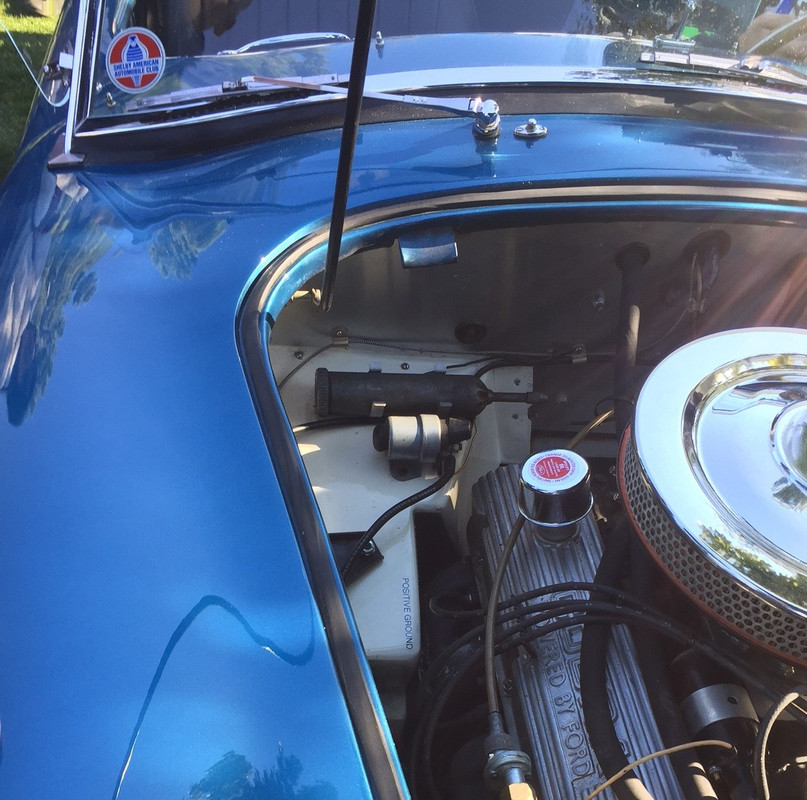

LMH 11-13-2018 06:48 PM
A COX car I saw a couple years ago. Note the "Positive Ground" tag on the footbox.
https://i.postimg.cc/j5DzBz4G/COX-Foot-Box1.jpg
