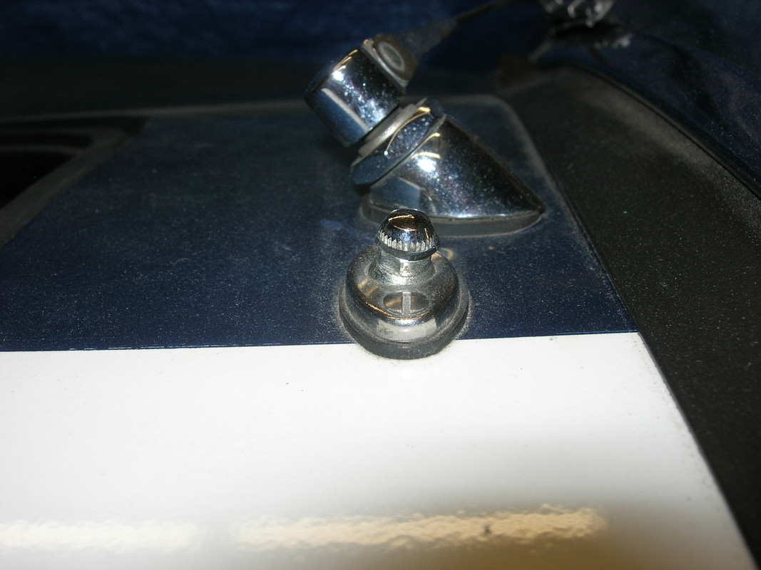

Could someone please provide a measurement drawing indicating the jet position compared to wiper and other points?
I need to drill some holes to mount it on my 289 and I would like to do it right. :)
strictlypersonl 01-08-2019 10:51 AM
Each squirter falls about 2" toward the car centerline measured from the wiper hole centerline.
http://www.erareplicas.com/fiaman/body/squirter.jpg
LMH 01-08-2019 03:13 PM
A couple photo's I have.
https://i.postimg.cc/8PBK5YDJ/CSX2297-Washer-4.jpg
https://i.postimg.cc/J7jK6Fs6/CSX2297-Washer-2.jpg
ALF 01-08-2019 10:52 PM
Hi Larry
Many thanks for the great photo's

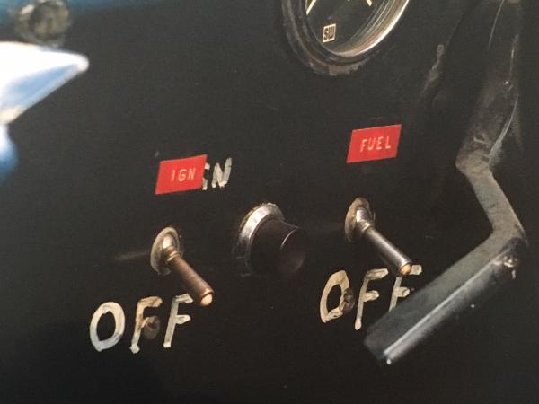

I found the following picture on the Shelby Cars in Detail Book.
It is the Dash of CSX2345.
http://www.clubcobra.com/forums/pict...ictureid=18103
This seems to me a Lucas button as used on the pre CSX2201 cars..?
LMH 01-09-2019 09:30 AM
That could be a starter button or washer button. Could be a horn too if required by class.
CompClassics 01-09-2019 12:40 PM
That is the starter button.

CompClassics 02-03-2019 10:51 AM
The white knob on the dash of 2345 is the dash light dimmer rheostat. The FIA roadster only used the on/off toggle switch to activate the lights.
ALF 02-03-2019 11:03 AM
They did use it only to dimm the dash light?
CompClassics 02-04-2019 08:02 AM
As I previously stated the white knob on the dash is for dimming the dash lights only, it is a simple rheostat only and not a Ford headlight switch assembl as had been previously stated.
