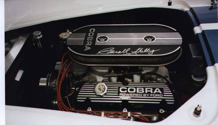

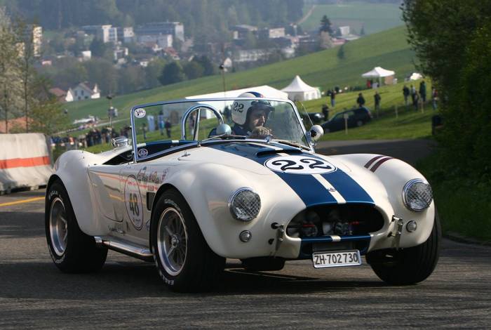

I started this thread, to find some information, what I should add or change on the look of my car.:cool:
Like the engine compartment from this:
http://www.clubcobra.com/photopost/d...otor_klein.JPG
Closely to this:
http://www.clubcobra.com/photopost/data/500/Motor4.JPG
And the outside look from this:
http://www.clubcobra.com/photopost/d...m/GTRZ5913.JPG
To??????:cool:
