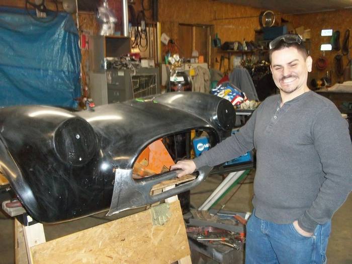

Last year I posted photos of the Gentry 289 FIA Fiberglas body I had purchased with the goal of using it for patterns to make an aluminum bodied Cobra. A friend purchased a 427 body at the same time and came over last weekend to pick it up. While he was here four metalshaping friends came over and we spent a couple days experimenting with techniques and deciding how we would approach building the body by making a wall hanging of the nose area. The nose area is the most complex from a shape perspective.
In about 60 man hours we ended up with this:
http://www.clubcobra.com/photopost/d...dium/A_143.jpg
http://www.clubcobra.com/photopost/d...dium/A_145.jpg
While not finished we made a great start on a wall hanging. Actually it will be a bare metal awning over the walk in door of my shop. I'm going to put a motion light inside and let the headlights glow as well as light the door.
There is still a small panel beside the left headlight to do, the inside of the grill openings, some metalfinishing, as well as wire edging.
We used a variety of methods. One guy used almost all hand tools and my English Wheel because that is what he had at home. Another built and used a concrete hammerform to make the lower nose area. Still others used some power equiptment. The panels were TIG welded and filed down with Vixen files.
If there is interest, I can post a lot photos of the build process.

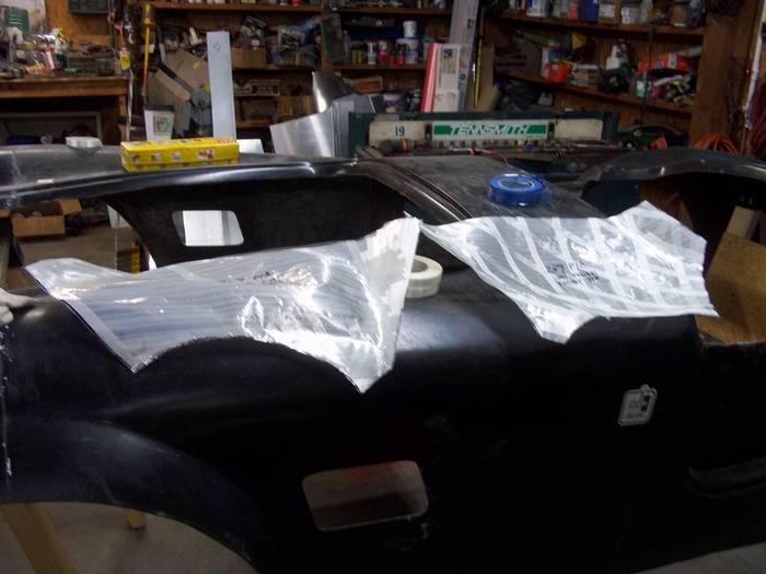

We started out by making flexible shape patterns (FSP) off the fiberglass body. Here Bob Baisden is making the pattern for the right fender top:
http://www.clubcobra.com/photopost/d...dium/A_003.jpg
http://www.clubcobra.com/photopost/s...3/ppuser/38468

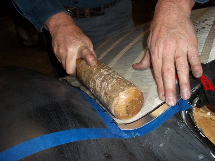

An FSP is a 'skin' of the shape. We work the metal until the FSP fits tight all over. If it is loose in the middle you stretch the loose areas. If it's tight on the edges, you shrink it. Easy....right? :LOL:
http://www.clubcobra.com/photopost/d...dium/A_007.jpg
Top of the nose all taped up. The FSPs are made from a non-stick layer (in this case Glad Press N Seal) and a layer of overlapping fiberglass strapping tape. The Fiberglass tape is what holds the shape. The non-stick layer just acts as a release agent.

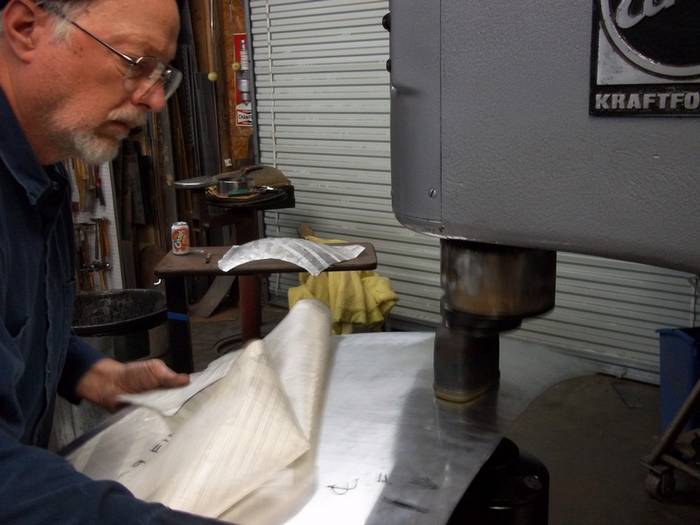

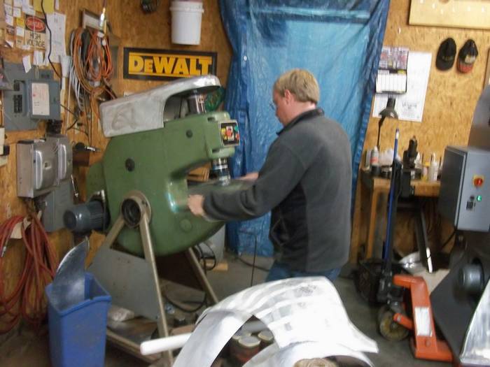

Bob is using an Eckold Picollo machine to shrink the fender top.

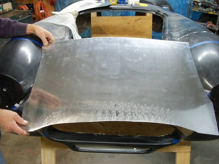

At the same time we were working on several other panels, including the nose center. The scuff marks you see in the front are from Eckold NOMAR shrinking dies. They are not really marks at all and easily wheel or sand out.

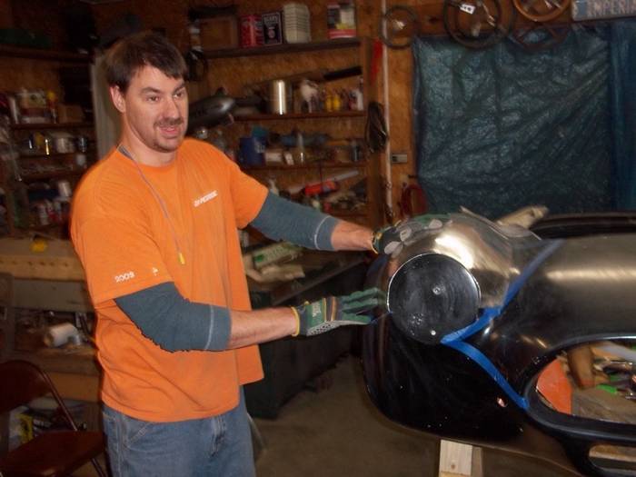

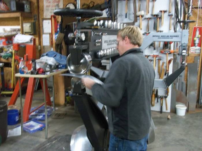

Here Bob is using my wheeling machine to stretch and smooth the fender top.

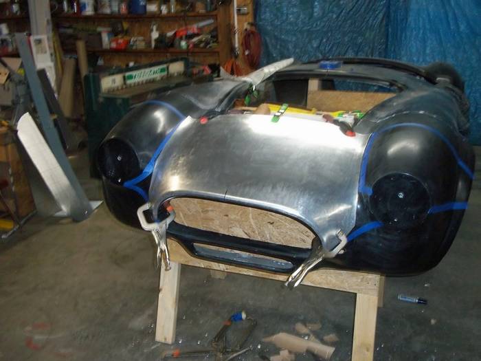

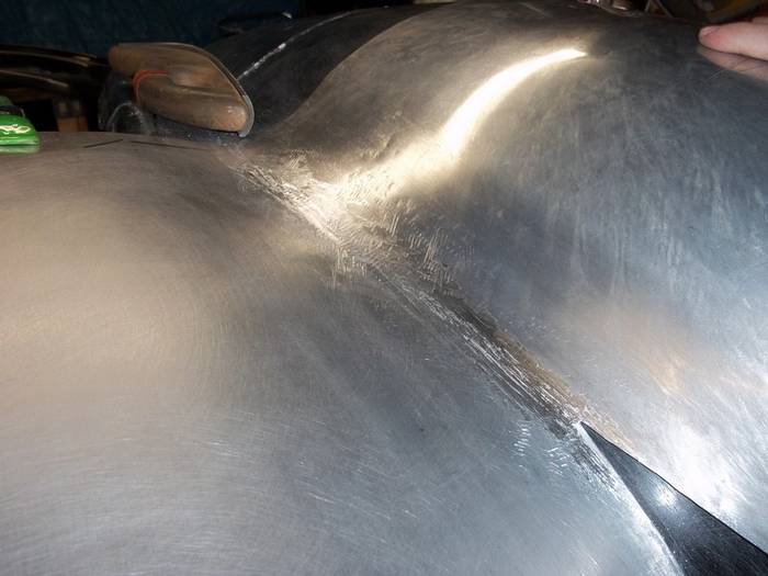

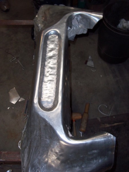

The nose center has these nasty little reverse curves at the sides. A reverse curve is a saddle shape and is the most difficult thing in metal shaping. Here I'm using a 'blodger' to persuade the aluminum to fit the correct arrangement. We worked directly on the fiberglass but were as careful as possible.
http://www.clubcobra.com/photopost/d...dium/A_023.jpg
Here I'm using a larger Eckold KF460 with NOMAR shrinking dies to work the panel. You can see that I've just flipped the FSP back. I'd shrink a bit, check the progress and repeat until it fit. Then take to the wheel to smooth.
http://www.clubcobra.com/photopost/d...dium/A_043.jpg
And here is the center panel, all done.

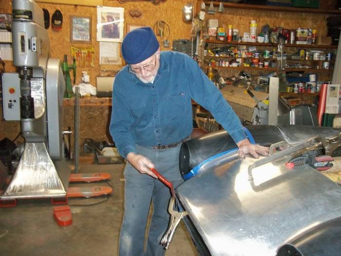

The grill opening was just gently slapped down around the fiberglass while the panel was clamped tightly to the car.
http://www.clubcobra.com/photopost/d...dium/A_056.jpg

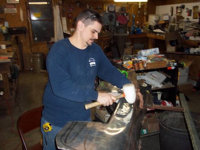

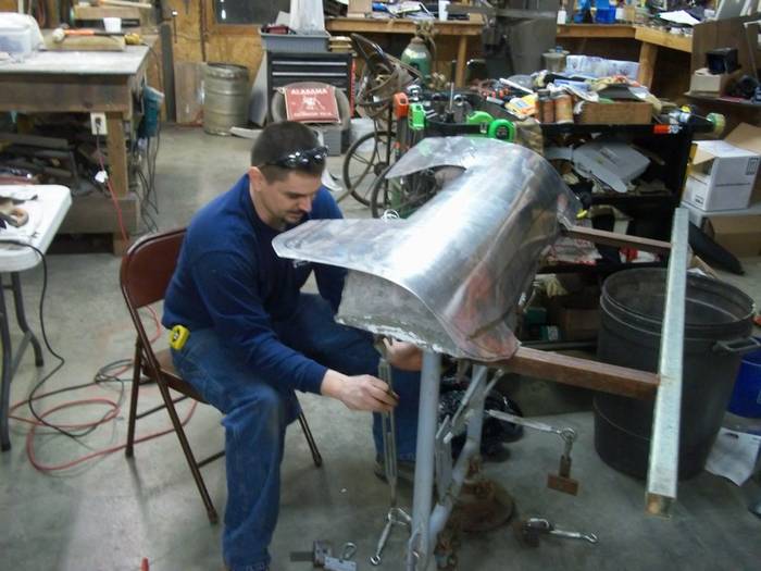

Jamey Hunter used only hand tools (hammer, beater bag, and stump) and the ewheel to make his panels because that is all he has in his home shop. There is lots of ways to shape metal. Everyone should start by mastering hand tools which can do ANYTHING that you can do with more expensive power equipment. As skills increase, power equipment can increase productivity....or, without an increase in skills, increase your scrap rate:eek::eek::eek::eek::eek:

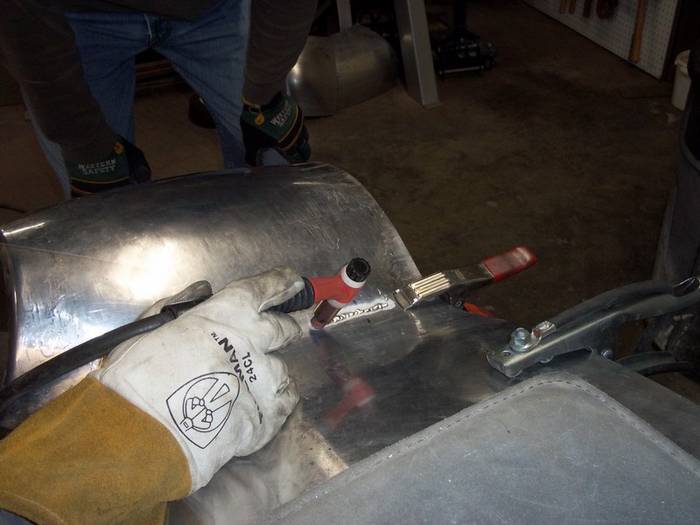

A closeup of the TIG welding process. We placed a thin strip of annealed roofing copper under the seam while it was being tacked. This protects the gelcoat from the heat and the weld from contamination.
http://www.clubcobra.com/photopost/d...dium/A_110.jpg
Once welded, the backside was fused with no filler and the weld was knocked down with an aluminum grinding wheel. Then it was filing time. For this panel, 90% of the file work was done with the bullnose vixen file you can see in the photo. I have lots and lots of vixen files and they all get used for various shaped welds.
