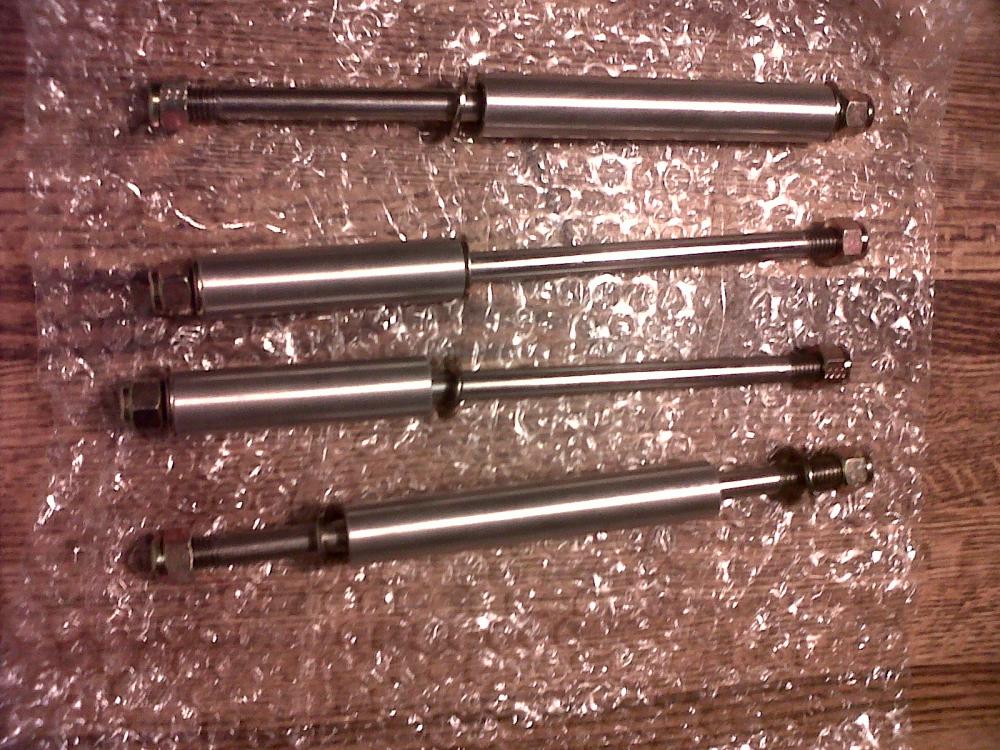

1985 CCX 07-29-2012 06:19 AM
Recieved hardware for the QJ, my wife bought this from Acton Custom....
Great accurate stuff............
http://www.clubcobra.com/forums/pict...pictureid=8317
http://www.clubcobra.com/forums/pict...pictureid=8316
Nice stuff Nick! :3DSMILE:
