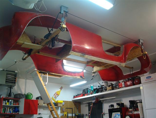

fasterpatrick 10-27-2014 07:27 PM
Originally Posted by ScratchBuilder (Post 1323860)
Dave,
I need to find a better solution for the body other than storing it on the frame:
SB
looks like your tight on space..... you could rig up something like this.
http://www.clubcobra.com/photopost/d...105_Small_.JPG
A lightweight buck and a couple of heavy duty bike lifts and its out of the way untill you need it.
Patrick
ScratchBuilder 10-27-2014 09:24 PM
Patrick,
Thanks!!! That is awesome and i will look into building one.

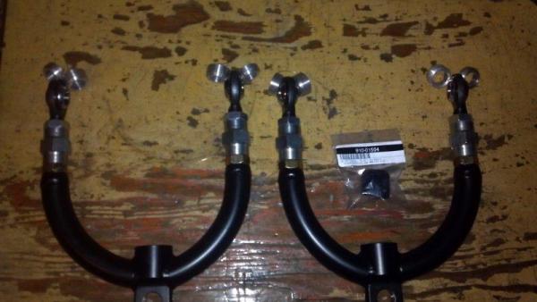

ScratchBuilder 11-07-2014 09:10 PM
Really happy with my new upper control arms, these are from another forum member and great quality:

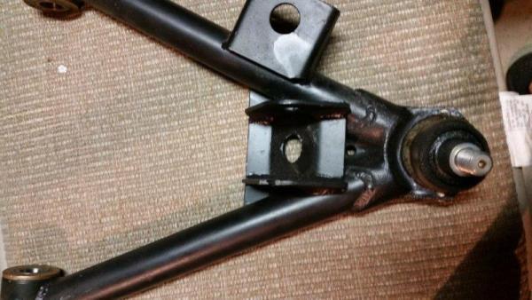

I've sent the lowers out for repair, will post pics of them when I get them back. Here's one of the lowers as pulled from the car:
http://www.clubcobra.com/forums/pict...ictureid=13035
