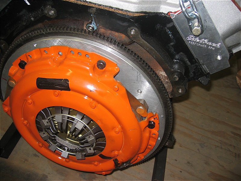

Rick Lake , I talked with the teck department at Summit .I mentioned about cutting the weights off the clutch . He said he never herd of that being done or an issue .He asked if I was side stepping it , no I said and intend on shifting in the hi rpm once in a while , he told me I would not have problems with this clutch shifting it hi up the rpm range . The weights add clamping pressure .
For you and one other person ( Doug ) both giving me a heads up on cutting the weights off , I would like to better learn and / or understand the idea behind it .Do you think you can shed some light here on you take ? Thanks !
Old 09-14-2010, 05:55 PM
Posts: 22,025
John, here is a picture of my Centerforce pressure plate when it was just temporarily bolted up to the flywheel (engine just sitting on a stand). Those little square weights that are on the fingers, and held by the circular wire. are what Rick is talking about. A lot of us pull them off. Chuck Brandt (fellow ERA owner) has a web site and he talks about the problems he had with the little weights before he removed them. If he revved hard at a stand still the clutch would start to engage and move him forward. I'm sure a search of this forum would bring up his web site and I remember that he took some shots of when he removed the weights.
