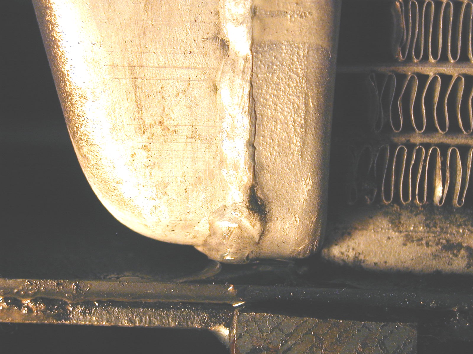

Well I bought an AirEvac from Mityvac. It is supposed to create a vacuum in the cooling system and sucks fluid into the system and eliminates all the air.
While hooking up the unit and trying to create a vacuum in the system I could only get about 7 or 8 in of vacuum. When disconnecting the air line I could hear a gurgleing coming from the radiator. I traced the noise to a small crack in the front of the radiator all the way on the bottom, passenger side.
I'm getting out my JB Weld and will report back tomorrow.
http://www.priveye.com/dls/rad.jpg
larger image at http://www.priveye.com/dls/rad1.jpg
Roscoe
Okiesnake 08-16-2002 07:26 PM
I wonder what the crack can be attributed to? Corrosion? Freezing? Over pressure?
Good Luck and Keep us updated how it all works out.

Roscoe 08-19-2002 09:01 AM
Well I epoxied up the crack and let it sit overnight. On Sat I tried the vacuum again and got over 20 in lbs of vacuum. It still leaked around the epoxy a bit but it looks like that was the problem.
I yanked the radiator and am waiting to hear from Griffin. I do not expect them to replace it and will probably have Afco Racing build me one to my specs: no filler cap, AN fittings, built in drain, etc.
Roscoe

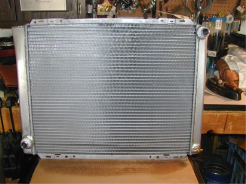

Roscoe 09-06-2002 10:49 AM
Next Friday has arrived as did my new Afco radiator. Will be working tonight and tomorrow to get this puppy back on the road.
