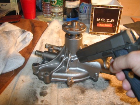

Roscoe 10-04-2002 01:02 PM
Steve,
Hard to see your pump but I took a good look at mine at is has 'Japan' stamped in the casting.
http://www.priveye.com/dls/pump.jpg
Roscoe

Slide 10-04-2002 07:24 PM
Rosco, glad you solved it. When I built my 351 I also used a Milodon high flow pump. Car would overheat within minutes. Turned out the pump was a reverse rotation pump,the vanes are curved, in spite of coming in box with a sandard rotation part number! Not easy to figure out.

Steve R 10-04-2002 08:13 PM
Roscoe,
Can you "SHOOT" :LOL: it from the same angle as mine? Steven

Roscoe 10-07-2002 12:07 PM
From my 'Your not going to believe this file':
I just got off the phone with Tom at Milodon. I ran the numbers on the pump by him (19157A7BRLGMB) and he tells me it is from a 351C-400 ('70-'79)
I told him all the headaches and hundreds of dollars I spent diagnosing the overheating problem. I told him I had my original invoice which states the correct part number and that the box that came in was properly marked.
He blamed it on PAW who he said probably reboxed the pump. I told him good bye.
