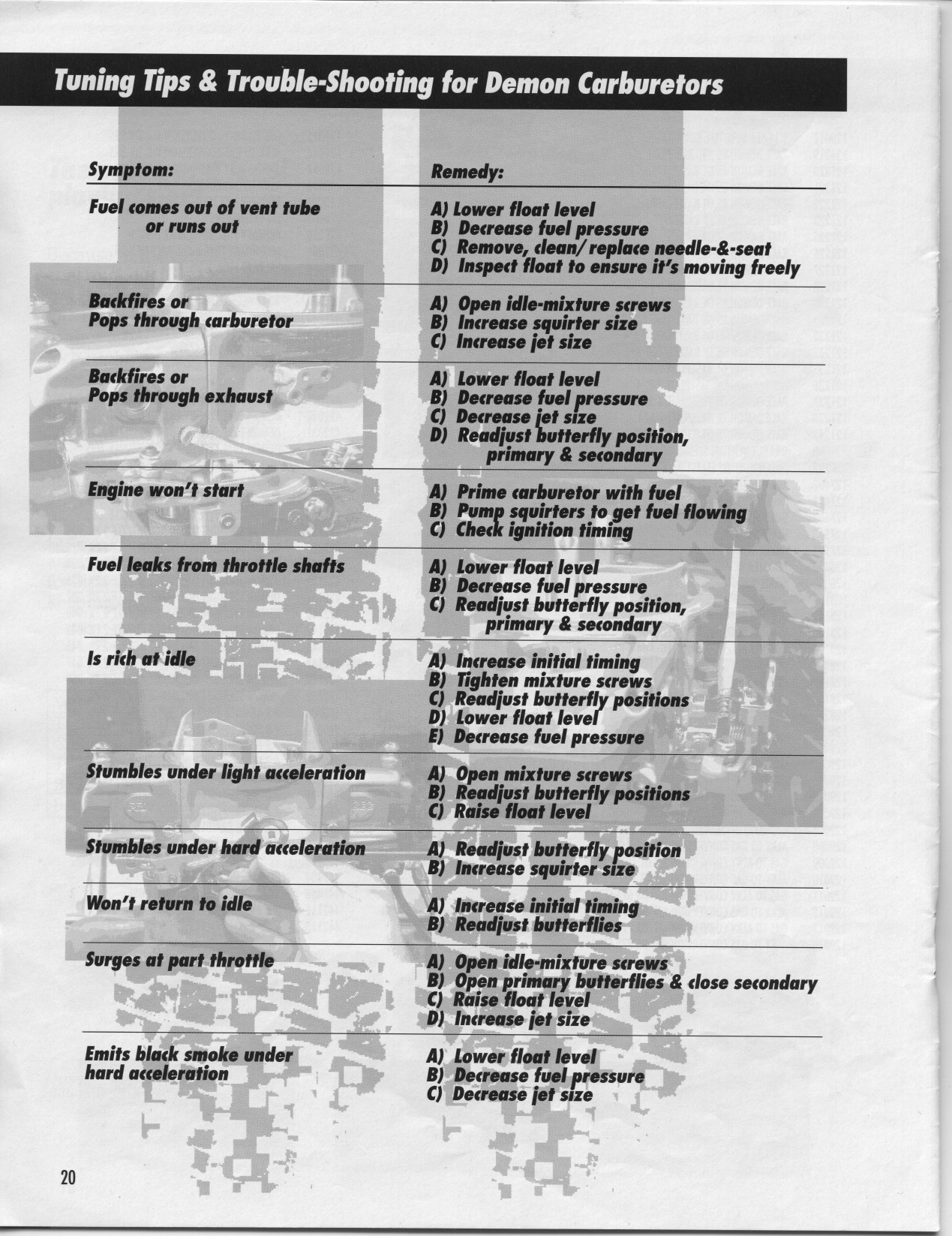

Here is the Demon carb tech sheet. No matter what carb you have some of it will apply.
http://www.priveye.com/dls/Demon2.jpg
Also check to see if your headers have loosened up.
Roscoe
