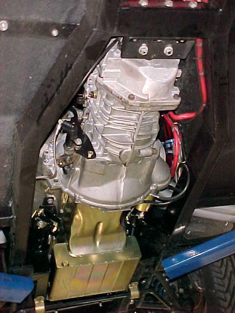

speed220mph 01-18-2004 11:49 AM
Wy not go with a small diameter, multi-disc clutch and forget the scattershield, what with all its weight and huge size? Even with their high revs, there's never been an F1 or Indy Car clutch explode? Check out the setup in Olthoff's SF roadster in front of a six-speed Tremec.
http://www.clubcobra.com/photopost/d...ec_6-speed.jpg
SFfiredog 01-18-2004 01:58 PM
A $350.00 safety bellhousing is much more cost effective than a $1000.00 to $1500.00 trick multi-disc clutch.
The main advantage to the muti-disc is their smaller diameter which allows the engine and trans to be located lower in the chassis. They are hell to drive on the street as well.
Also, the trans in your photo of Olthoff's car is a Tremec 3550 5 speed.
--Mike

speed220mph 01-18-2004 02:12 PM
Mike: Guess I blew it on the Tremec, so that's the one mistake I allow myself per year!:LOL:
Anyway, to go along with the clutch, you'll need a small diameter flywheel and a starter that plugs in from the back side. What I failed to put in small print is this setup should be reserved for the track and well-healed bank account, but if you're willing to put up with an aggressive clutch, it will work on the street. This setup is not for the faint of heart and around-the-town driving.
Oh, another advantage of the small clutch/flywheel and small aluminum bellhousing is reduce weight and low inertia, which gives improved throttle response.
