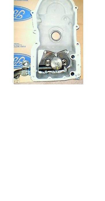

Does your front cover look like this?
http://www.clubcobra.com/photopost/d...7cover-med.jpg
If so, maybe you would have been time ahead to just remove the front cover with the pan attached in one L-shaped unit, from the front.
What/Why exactly are you going through this exercise.
I know when I swapped oil pans (non-dry-sump) I loosened the engine mounts and jacked the engine up slightly to give me more room. If you need to slide the pan backwards where there's no room and nothing but bellhousing, I can understand your difficulty. Which just makes taking it all off to the front seem the way to go. Hindsight is always 20/20 though. :(
No, the front cover is completely different. The front cover actually rests on top of the front portion of the oil pan. Pulling the front cover will not give me enough access to get to the one bolt that is inside and I am pretty sure the bolt goes into the block. FWIW, the guy I spoke with at Dove today referred to this as their "Can-Am" motor they were building a while back.
The reason I am going through all of this is because of multiple oil leaks...both halves of the oil pan, dry sump fittings on the oil pan, and the rear main seal. We were originally told we could pull the pan and gain acces to the rear main which is supposed to be a two-piece seal. Obviously, it is turning into a bit more of a project than that...
