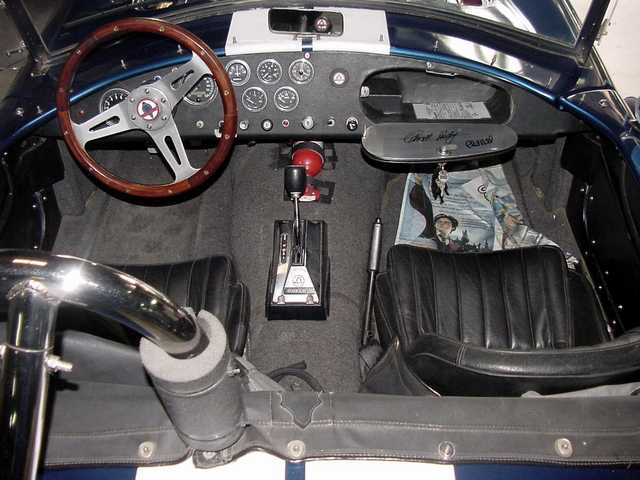

binggy 07-19-2005 06:30 PM
note the signatures on the glove compartment ... signed by the gods when they visited (properly clear-coated) :)
http://www.clubcobra.com/photopost/data/500/235153.JPG
