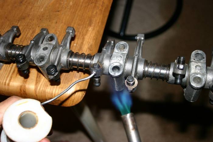

The $500 new rocker arms I bought need to have a 'drilled hole' due to machining 'plugged' before use. It is MY responsibility to plug said hole. Sheessshhh, you'd think for $500 bucks they would plug the dang hole as well! I'm thinking a drop of solder... Kind of like building an FE, there seems to be a number of 'tricks' to this engine that aren't in the 'book'.

The new rocker arms had a hole that required soldering closed to maintain oil pressure to the rocker arm bushing and limit oil to the top end.

Pete Munroe 08-09-2007 07:21 PM
interesting engine build...but...SOLDER?
Am enjoying this thread on the A/H 3000 build.
I am not sure I would trust a blob of low temp solder to plug a hole on a rocker arm.
There is high vibration and some residual oil pressure conspiring to pop the solder plug out. Although solder is soft, I don't think I would want it floating around in my expensive engine build up.
At the least, can you get them BRAZED?...I was gonna say silver solder but brazing I believe is a lot stronger.
Best would be remove them, tap them, and put in a threaded plug. You are in pretty deep $$$, I would hate to see your effort compromised.
Maybe some of the machinists/engine builders reading have some ideas on the topic.

Excaliber 08-09-2007 07:31 PM
After looking at my options for a 'plug' for that area I feel reasonably good about soldering it. A lot of that is because of the technique I used to make sure it has a good and deep in the hole bond. Am open to further suggestions on the topic however!
Jac Mac 08-09-2007 09:39 PM
A piece of alloy welding rod of the appropriate dia pressed in and the end of the hole peened over slightly should suffice.

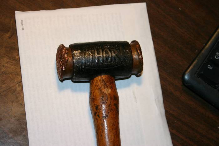

thudmaster 08-10-2007 12:40 AM
Ernie I noticed your small hammer in the first picutes. When I had my Triumph GT6 I always had a mini sledge nearby. It made it easier to hit my thumb and did more damage to the car and engine parts. These pictures bring back nightmares. I'm glad you shared them with us. Good luck.
Excaliber 08-10-2007 01:35 AM
:D This is my prefered hammer, by Thor of course! My son was surprised how often we used this hammer for diassembly as well as assembly.

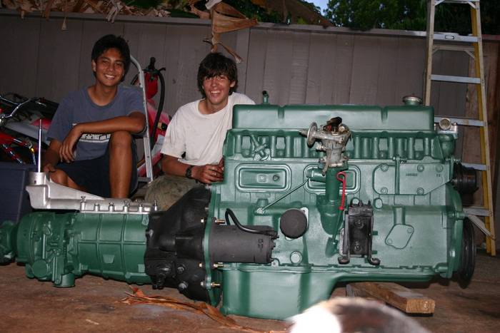

Excaliber 08-13-2007 10:18 PM
Ta Da!!! Almost ready now, with a little help from my son and his friend. "Wrinkle" finish black on the bell housing, water pump, front pulley, motor mounts and generator (my trade mark). I thought it needed a little 'spicing up' as to much green all ready! :D Starter in hi temp flat black, but I think we'll redo it in wrinkle finish black as well...
