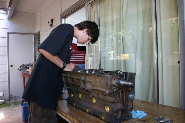

My son, Dusty and myself are rebuilding a 1962 Austin Healey 3000 engine and trans (4 speed with Over Drive). I'm posting some pics and 'blogging the build' for the owner, Bob and my family and friends.

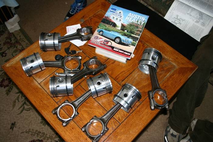

Machine shop work came to about $1100, parts have added another $2500 plus at this point. Bore, mains and rod journals are all .020 resized. The new 'slugs' are FIVE ring! Three compression and TWO oil control. The original slugs were only four, I have no clue why 5 is better than 4 and why not 3? Go figure!
Crank, rods/pistons are now installed in the block. The trans was good, only the synchros were replaced for 2nd, 3rd and 4th. No synchros on 1st gear. Installation has been pretty straight forward with no problems so far.
Ernie

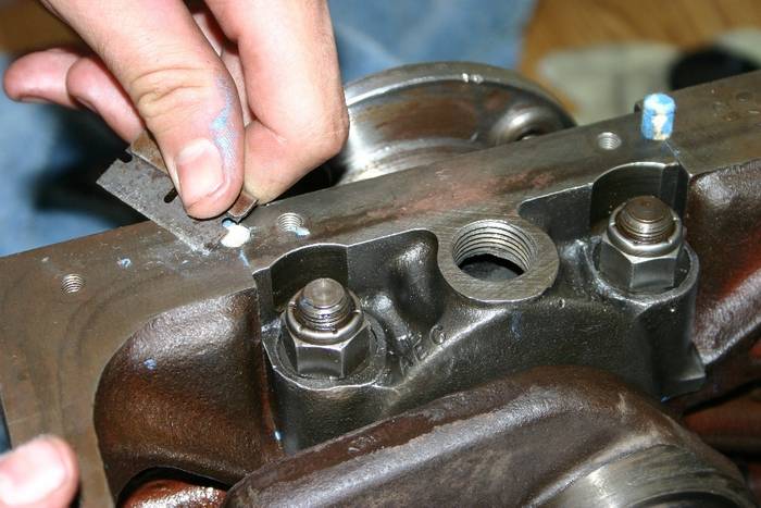

Interesting note on the rear main seal for this engine (and MGA's were the same). There is no 'rear main seal' per se. Dusty is trimming the SIDE seals of the rear main cap. The 'oil seal' method at the crankshaft is simply a threaded type groove on the crank that runs really close to the block and rear main cap and 'throws' the oil forward back into the engine. When the motor is stopped residual oil slowly seeps out the rear main and 'leaks', as per specs! It is designed to leak, what a concept!! :LOL: The Healey manual notes care should be taken to make sure the hole in the bottom of the bell housing is open so the oil can 'drain' (you know, onto the garage floor)!

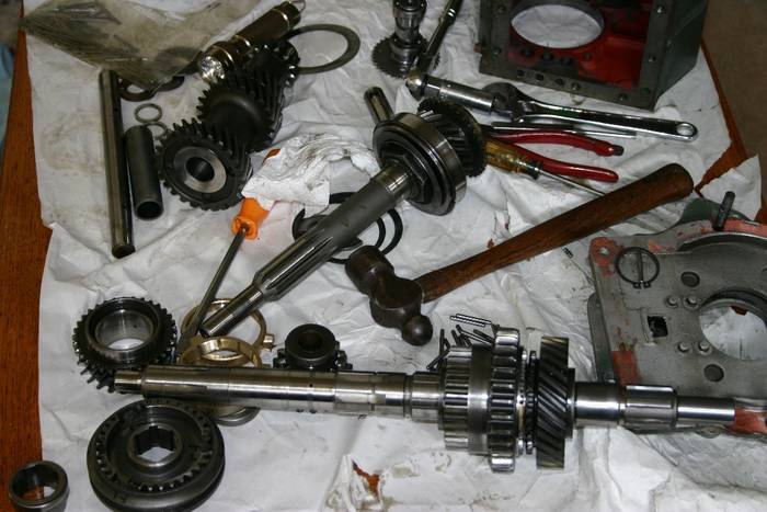

..and the trans..
http://www.clubcobra.com/photopost/d...rans_gears.jpg
