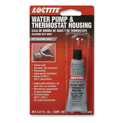

patrickt 12-29-2008 02:41 PM
Magic Goo:
http://static.summitracing.com/globa...t-37473_cp.jpg
