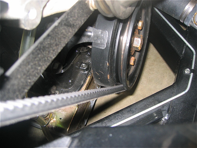

Even I can't tell you via this forum where your timing tab should be.  But I can show you a pic of mine with the piece of metal tack welded to a pointer to be at exactly the right spot on my engine. Here it is -- I read the timing marks at the BOTTOM.

LOL thanks for the reply Patrick. I was a Chevy guy for years in Drag Racing and never had any problems with timing until I switched to Ford  . Geesh, 10 o'clock, 11 o;clock, 2 o'clock, blank timing tabs, pre 1970, post 1974, big block, small block, 28oz., 50oz. Its been a learning experience but I have my dream car and I am having a blast. My tab has a curved outer edge on the bottom side and a flat square edge on the top. I finally call a local Ford shop that has good mechanics that have been there along time. The guy I spoke to knew exactly what I was talking about. He said don't read the bottom with the rounded outer edge. Read the top.
Lou

Patrick, I was searching threads looking for info on FE timing pointers and found this slightly dusty thread. After pulling the alternator, I pulled the timing pointer as well to clean it up and perhaps powdercoat it - and found that someone, I assume Joe Lapine, had brazed an extension tab to the bottom. It looks much like yours but not as neatly done.
What's up with this? Why would a stock 6.5" damper need anything but a stock pointer? I've searched for a replacement and found 50-zillion for SBFs, as many for Chebbys, a handful for Ford 358s... but nothing for FEs.
I guess I'm going to have to TDC the engine to be sure. If anyone can explain this weird offset, or point me to a decent (not $$$ billet) adjustable pointer for the FE, I'd appreciate it...

It's the combination of new parts. You have a new crankshaft, along with your new damper (maybe the degree lines are where they were 40 years ago, maybe not), so TDC doesn't show up where it did 40 years ago. Neither does your cam. Maybe you've got an off-size timing chain, cams aren't always ground exactly as you think they are, so puttiing the key in the 6ADV slot does not always mean your cam comes up exactly six degrees advanced. You have to degree it (well, you don't... it's already been done for you.) Go ahead and use a piston stop and find TDC, my bet is that it's going to be right on the money with the fabbed pointer.

IMO, the factory timing marks are just not that accurate. They're good enough for the average street car. But for performance use you really need to accuratly identify TDC. As said above, the differance between performance and detonation is only 2-3*.
So, I made my own pointer to match the balancer marks. Nothing fancy, just some 1/4" rod welded to a washer.
