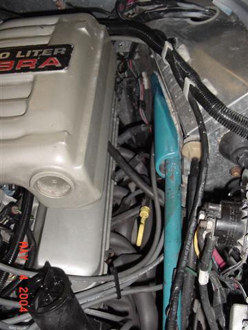

One thing that seems like a major constraint is the headers. I have the stock headers, feeding a j-pipe. The headers are small, and seem kinda crimped in a bunch of places. I don't have a great picture to show them, but here's one look at them:
http://www.clubcobra.com/photopost/d...SideHeader.JPG
Since the motor starts petering out at about 4k, maybe that's when the exhaust is really starting to be too much for the size/style of the headers, and starts limiting the power?
Does anyone have any thoughts on my motor and numbers? Do the numbers seem right for a fairly well built 302? Does my theory about the exhaust seem correct?

Sidepipe Restriction.
Hi,
You have mismatch in your system somewhere.
My '87 put out 244 rwhp with only mufflers and ported stock heads,timing at 13*. @ 4,500 rpm.
That said, my '91 pulled hard to 5,300 rpm with the B303 cam so I think you have an over restricted exhaust, I would go to 1 5/8" shorty headers, 2 1/2" 'S' pipe and a better sidepipe, they can choke down 50 HP. Bump your static fuel pressure up to 42 PSI, timing to 12* with your compression, 180* thermostat, plugs set at .044 .

HighPlainsDrifter: good info. I definitely think my problem is in exhaust flow. I'll start looking this weekend at the different options.

Regardless of what you might have been told it seems you DO have the torque cam. The stock FFR headers aren't that bad, they will easily support 5000 and higher rpm.
