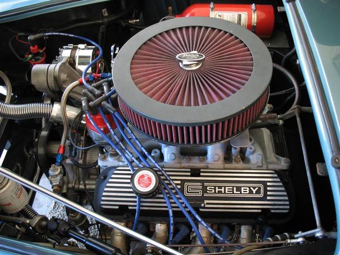

Allan A 03-25-2006 03:48 PM
I was able to get 358 HP at the wheels with this motor. Runs on pump gas and so far has been very reliable.
http://www.gessford.com/cobra/images/CSX7034.htm
Tongue Pirate 03-25-2006 03:57 PM
Allan, You have that overhead shot in higher resolution? Would love to use it for background on my computer. Awsome shot!
Allan A 03-25-2006 04:02 PM
Hyde,
Sorry, I shot it with an old Mavica from the top of our office. Need to buy a good camera one of these days.
Allan
Tongue Pirate 03-25-2006 04:05 PM
Well then I'm just going to have to copy your idea!:p
