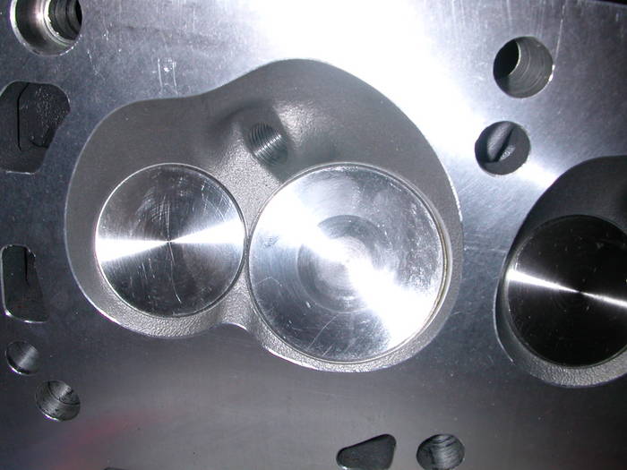

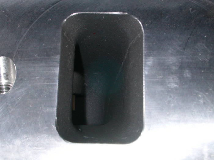

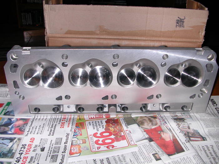

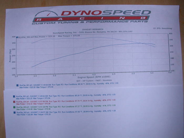

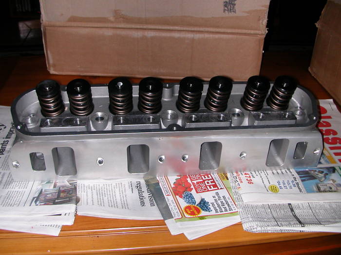

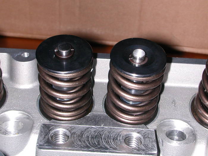

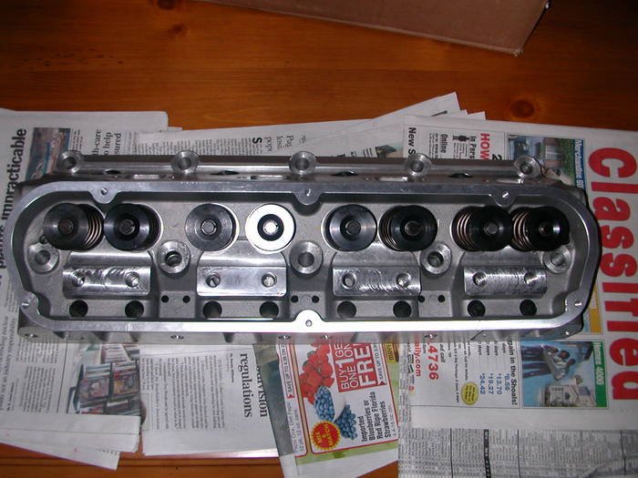

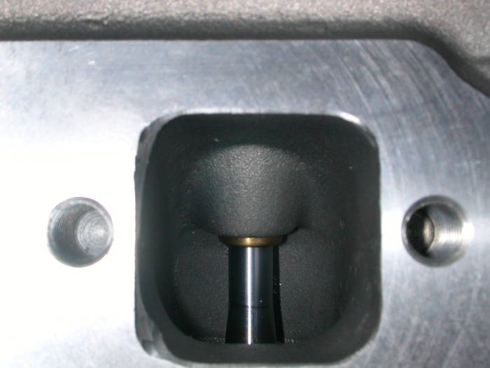

I have a set of 195 Pro Comp heads. They look good and so far perform well. I need to change my cam for more top end HP/ rpms. I had a Ford mechanic with racing experience help me build my motor. He liked the way the head look. I know looks does not make HP. For $760 delivered, I thought I would try them. I hope these pics help.
Dwight

Rick Parker 09-08-2007 05:27 PM
Do the rocker stand holes have helicoils (thread inserts) in them? Without them, sometimes the threads will pull after some time. Otherwise they look real nice.
WildBill3 09-08-2007 06:39 PM

Dwight 09-08-2007 07:35 PM
Yes, they have helicoils.

Ya, those heads don't look bad. Looks like they could benefit from a gasket match but otherwise not too bad. The 210cc heds are $795.
Dwight, what cam are you running? Did you upgrade the springs? Anybody have spring recommendations if I were going to run one of thses cams?

My Comp Cam is 35-518-8 XE274HR-12 with 1.7 roller rockers (long story) which gets me .590 - .600 lift. With the Pro Comp heads and this cam, all my power is at low rpm. Easy on the motor and very forgiving to drive. Start off in 2 nd or 3 rd, cruise at 1400 rpms, a lot different from the other 5.0's I've had in this Cobra. But no high rpms. I LOVE the sound of sidepipes at 6,000!
gross valve lift .555 int .565 ex
duration @ .006 tappet lift 274 int 282 ex
duration @ .050 224 int 232 ex
lobe separation 112.0
You can go to Summit and look at all the specs for this cam.
I may change the cam this winter but it's strong, fast and easy to drive. I'm going to drive it for a while and see.
Dwight
