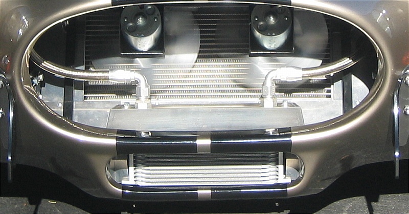

patrickt 04-01-2010 08:20 AM
Originally Posted by Jerry Clayton (Post 1040857)
red and blue fittings from disco era?????
How about red and blue fittings from the Cobra era?????
I like my silver ones better.

dcdoug 04-01-2010 08:59 AM
x2. I am have a few red and blue anodized connections in my engine bay and am working to replace all of them with silver fittings, or brass in a few cases where that was the original look.
