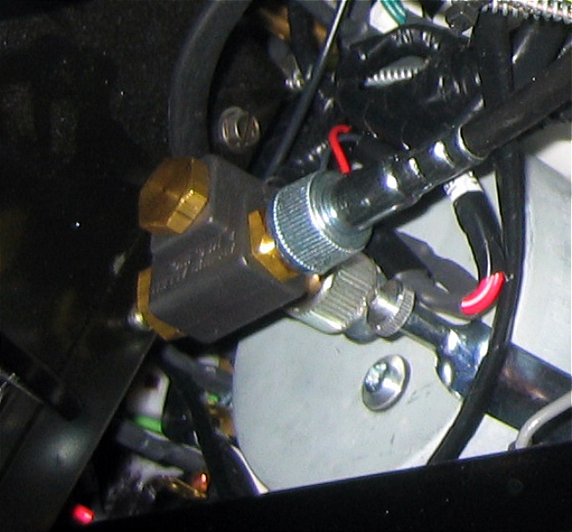

That's the reverser. If you have a Toploader or a Tremec along with your counter-clockwise speedometer, then you have to use a cable reverser on the end of the speedo cable. This is not true if you have a Richmond Gear transmission. Here is a pic of the back of my counter-clockwise Smiths speedo and the reverser (because I have a TKO).

wow! thanks for that picture, your reverser looks much better made then mine. Mine doesn't have the copper caps that yours does. I will post a picture shortly. Apparently my father had Superformance fix this a few times only for it to go bad again, maybe I just need to replace the entire reverse with a better one like yours. Do you have a part # for that? thanks!

Now it's been a while, but I'm pretty sure that's part #BG2410-80 available from Nisonger Instruments. Nisonger Instruments :: the exclusive Smiths U.S. Warranty & Service Center since 1949

Note the part in Patricks picture can be assembled to be a reverser or a 90 adapter. Unscrew the ends and switch them to switch direction. Make sure the inner cables are long enough to stay engaged with the drives.
