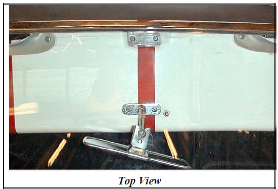

Here's a rip from my ERA stuff. The mirror is not supposed to be right down the middle.

Wow!!!! what the reason for the offset? Yours is also in front of the snap post.

I don't know. Maybe they just started doing it that way for a really goofy reason, or for no reason at all, and then just kept doing it that way because "that's the way we've always done it."
