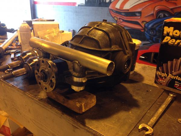

Thanks Larry. Pic of diff mounting cross brace. Original factory mount broke before I got around to this project. So car now has 31 spline half shafts, Truetrac, 3.91 gears, Ford Racing diff cover, and solid mounts.
vatdevil 12-08-2014 02:45 PM
Update from last post.....All went well on install. Less wheel hop with solid diff bushings. A little increase in NVH, as expected. The 31 spline inners from Ford fit perfect. The truetrac provides better traction, especially when accelerating out of corners. So much so that the car became tight, as the front wheels would loose grip first when accelerating out of corners. Highly recommend the truetrac over Trac lok.
