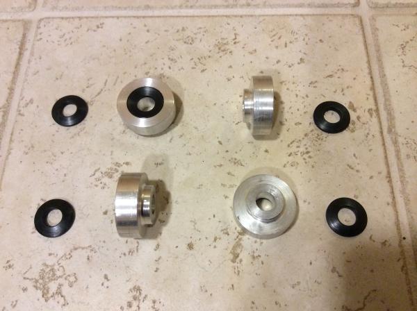

vatdevil 03-29-2014 03:56 AM
http://www.clubcobra.com/forums/pict...ictureid=11785
Solid mounts from Craigs Cobras

Some yes. But thats not the main reason for my upgrading. I want the performace gain of the Truetrac and to eliminate wheel hop (solid mounts). Upgrading the halfshafts just seemed logical to do with other changes.
I will also convert the back mount to solid. Pic to follow when complete.
