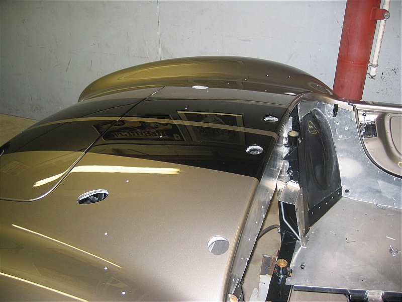

First the dealer had two rollers for us to look at. The cars looked good, fabrication looked good, glass work was straight. Very sexy car, is it authentic? I am not sure I care that the body lines are "correct", they are in good proportion and look good. I am still seriously considering 17" rims so the authentic part is questionable anyway. I sat in the cockpit and the pedal setup would take some getting used to. Everything is jammed up to the left.
I guess that is the price for cramming a large engine in a small car. I have to say overall it looked like a quality build. I would put two roll bars in. I know this is frowned upon by everyone buy Patrick and I like the look better with one but I think it is prudent to have two (if they mount to the frame).
Two things the ERA web site questioned was where the outboard portion of the roll bar mounted. From an assembled car I could not tell. Second the body side of the door latch is not mounted to the frame but mounted in the fiberglass. I could not confirm either of these. Has anyone had one torn down enough to tell me where the outboard leg of the roll bar mounts? Can anyone confirm what the body side of the door latch is mounted into.

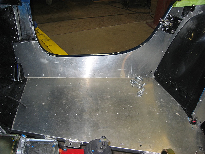

The door latch receiver is mounted to a steel plate that is embedded in the fiberglass. Likewise the pins for the top and tonneau are machine threads into an embedded steel piece.
The outboard roll bar mounts to the frame, you do not see the mount as it is behind the bulkhead unlike the inboard downward leg of the bar which is in the cockpit.

And here's a shot of my latch. It has aluminum between it and the frame, but if you go here: FIA Chassis illustration and here: http://www.erareplicas.com/427/chassis.htm you can see how mounts below the aluminum.
http://www.clubcobra.com/photopost/data/500/latch12.jpg

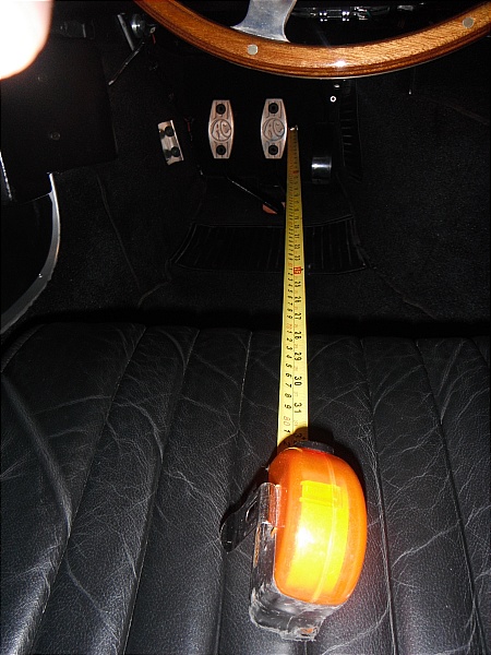

The pedals are offset to the left slightly in all SPF and CSX Cobras that I've ever seen due to the transmission tunnel, as were the originals. I suppose it might be possible that Backdraft or others have compensated for that. I never noticed it (at least to the degree of making me uncomfortable) when driving it.
The bigger thing is the cramped quarters. Big feet with big shoes don't fit well. I drove mine with sneakers almost all of the time. I never got into the specialized driving shoes.
The other thing is that the horizontal pedal offset of the brake to accelerator make heel-toe throttle blip/braking difficult if not impossible for most people. That's just the way they are!
Behold... the brake pedal's right edge is straight down from the middle of the seat, and I can heel-and-toe with no difficulty. I can blip the throttle with my right heel, while on a hill at a stoplight, without the slightest trouble. Now, they did do some adjusting on everything so it would be like this. And yes, that's a dead pedal on the left.

twobjshelbys 12-30-2014 03:13 PM
The ERA has floor pedals. The CSX has top pedals. It was going to be a bear to change the planarity of the throttle with that configuration.
Different construction.

Patrick - did you mention the reason the seats line up with the pedals is because the seats are also canted slightly to the outside.:D
Mine are not set in the stock holes -- they are back from the original holes and certainly appear to be plum square.:3DSMILE:
