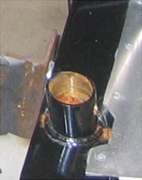

There is a large heavy sleeve welded on top of the frame. The roll bar ends slip in to that sleeve so they are resting on the frame. A bolt then goes through the sleeve and the bar. The trunk brace is a little different.
http://www.clubcobra.com/photopost/d...0/bigmount.jpg

Thanks Patrickt.
