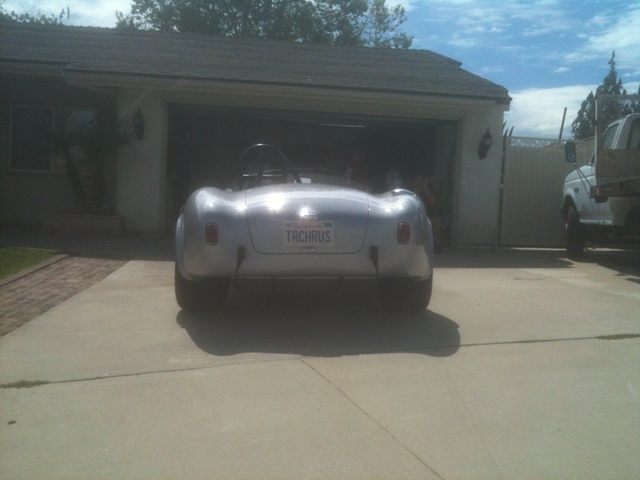

Old 06-28-2017, 10:56 AM
Location: Rancho Cucamonga, ca
Cobra Make, Engine: SPF 239
Posts: 820
Old 06-28-2017, 10:58 AM
Posts: 820
325-50-15 M/T ET street Radials

Old 10-18-2017, 07:16 AM
Posts: 820
Inertia,
the wheels are original (1998) Superformance knock offs.
I believe they were listed at 15 x 9.5
Jason
