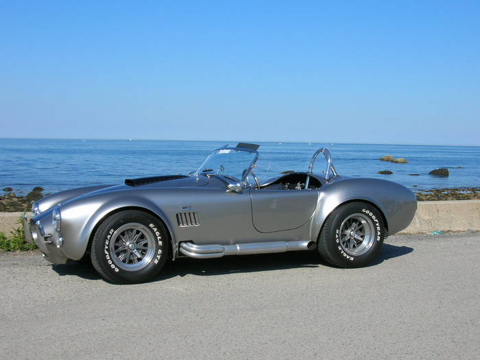

I've added a picture to my gallery that shows the nose high attitude. I guess I'll start by dropping the front to 27" or a hair under and see how it looks. If it still doesn't seem balanced I'll raise the back a little.

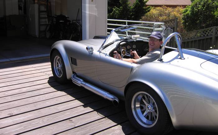

I don't have my car right now, so I can't measure. Here's a side pic though.
Doug
