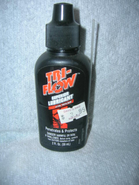

I have some teflon based bicycle chain oil that I use on various parts that move on the Cobra (hinges, trunk support struts, etc).
Its not greasy, does not drip and works great.
Warren
