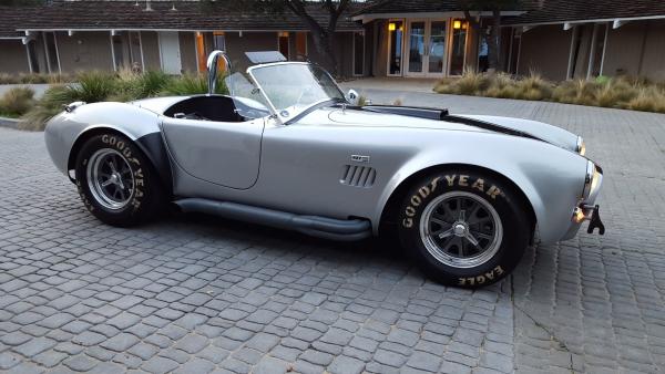

Luke427 01-31-2016 01:50 AM
Hi,
17" may handle better (and to be honest I've tracked quite a bit and am still not totally convinced about how much, as chassis setup correctly tuned and tire compound have more to do IMHO) however I really like the look and feel of the big fat 15" :cool:
