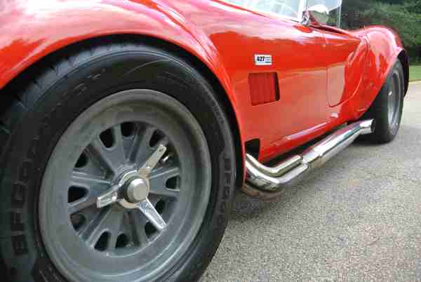

Red427 05-05-2016 05:37 PM
mystery magnesium wheels
Does anyone out there know if Halibrand made Cobra magnesium wheels in 16x8 and 16x10? I just bought a 427 S/C replica with these on the car from a dealer, who doesn't have any documentation on them. They are definitely magnesium, are 6-pin drive and look just like originals. I looked them over pretty good and can't find any numbers or the Halibrand name on them, so could be repros from another manufacturer?

The wheels have places where you can see oxidation (white powder), they have the right color for magnesium wheels. They have been clear coated apparently some time ago, but finish has worn off in places. The previous owner tested a small spot of bare metal with vinegar to see if it would react, it did. I have removed them, they are extremely light for such big wheels. I wonder if Trigo or some other manufacturer tried to duplicate the Cobra II wheels in magnesium.

Thanks guys. I am glad I'm not alone legenmetals! Mine is a Contemporary also, I'm guessing build was in early - mid 90's as far as I can tell, it is #33237. Peter Bayer probably knows history of these wheels. Is he still around? I would like to get another one just like my front wheel to use as a spare.

cycleguy55 05-06-2016 05:02 PM
Would these be the wheels? Club Cobra - Red427's Album: Shared Photos
http://www.clubcobra.com/forums/album.php?albumid=3531
Red427 05-06-2016 05:11 PM
Yep those are the wheels I had trouble attaching them to my post but anyone can go to my shared photos and see them. Sorry about the picture quality. I'll add more in a few minutes.

Thanks 1ntCobra - I get a "moderator has to approve before posting" message when I try to attch photos, and the post never shows up. Anyway I am dying to know how many were made, where distributed, or anything else I can find out about them. I plan to keep them on my car but need a spare one for the trunk and it would be good to know if some are still available in case I ever need more.

Spoke with Lynn and showed him the photos. His opinion is they may have been made by Halibrand because they were known for not marking all their wheels. He thought they may have been made for another application,but not for a cobra.

Wheel photos and first FIA car built #16
4 Attachment(s)
Attachment 27873
Attachment 27874
Attachment 27875
Attachment 27876
