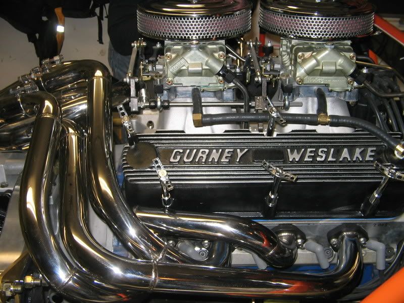

I ran a tunnel ram on my '41 Willys and on my GT40. Both topped off with dual 4 barrels. They were awesome, even at low rpm, but that was mainly due to low vehicle weight. If this is a specific weber questions, then I have no answer. Sorry, but here are some pictures:
