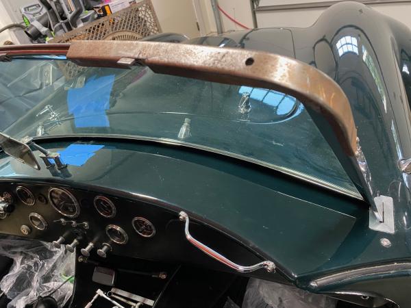

Default And another hardtop project.
Picked up the Butler hardtop a whole back that was for sale on here, and have finally gotten around to installing it. My car is a B&B and it is amazing how well the top fits. Had to tilt the windshield back a bit (Hey!! it's a B&B huh?) but the area in back fits nearly perfect and the sides will only take a bit of tweaking. I will need to machine up some pieces to fit into the soft top ferrules and will install some stainless steel over center clamps entering into the bottom of the ferrules to hold the rear of the top down. In front, the top came with come formed sheet metal pieces similar to the ones that attach a soft top. Think that I will use these and make a couple of stainless steel angle brackets to bolt to the top of them and epoxy to the underside of the hard top in the front. Question that I have for those of you versed in fiberglass work is: What kind of resin should I use? Haven't done any of this kind of work in about 30 years and have no idea what is on the market nowadays.
Thanx in advance and more pics coming.
