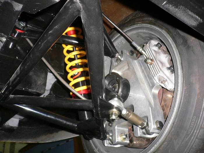

Sambo, my Harrison has billet aluminium rear uprights using Commodore hubs/axles/diff.

You know you want 20" wheels. Don't Subi's use Brembo? Calipers are easy, it's getting the disc offset that's the pain. Those dogbones in the picture are similar to mine. Was your engineer specific in his concerns? Every man and his dog seems to make/rebadge calipers these days.
