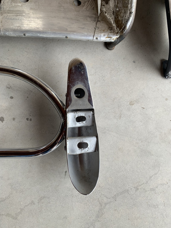

So thought I'd post these for some clarity on original Cobra over riders, These were removed form an original Cobra and I believe them to be original. The fronts are kind of rough, the rears much better but they're over 50 years old.
Front AMCO grill guard is also original but the fasteners are not.
Rear over riders:
For the record, there's no such thing as a "Gen 3" Cobra. Originally, there were Cobras and then Cobra 427's. Both were produced in England by AC Cars. Ford did the design work on the coil spring suspension but did not supply parts for the Cobra 427 except the engine /transmission/ancillary parts for the drivetrain.

THE ORIGINAL PIECES WERE CAST, NOT STAMPED AND THEY WERE NEVER EVER PRODUCED BY FORD.
Certified my a$$
Buzz, the original over riders are die formed and cut to shape, not cast. What I was trying to show in my previous post was what original over riders look like.
I should point out that BSF caged nuts and hole plug would also be used but aren't pictured.
If Everette Morrison wants to make and sell over riders, more power to them but they shouldn't be represented as original nor produced on original press dies nor should EM push a false idea that Cobra 427's were built by Ford. They weren't. That's really all I'm saying.

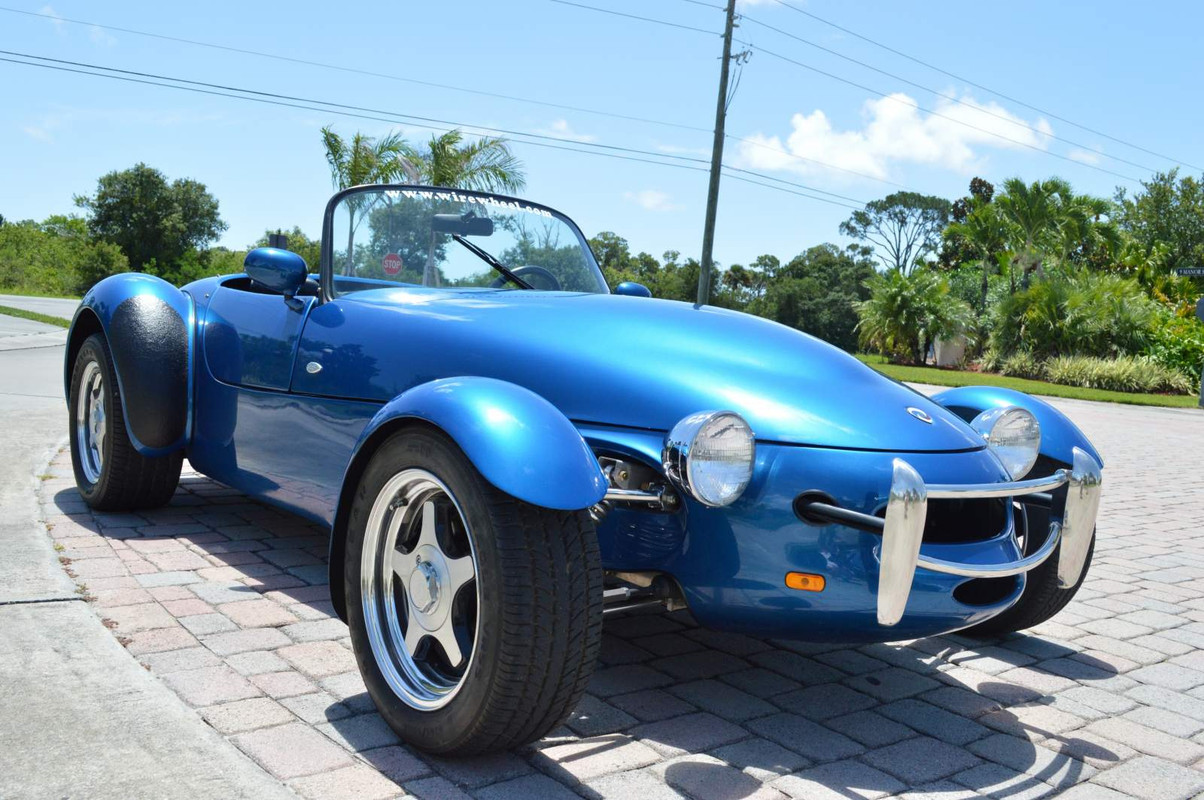

I'm going to throw this in the mix for discussion. I have no idea where these came from or who produced them. I only know Ford supplied many parts and assistance to Panoz for production of their roadster. Look at the over riders. What do you think?

My mistake about the casting vs die-forming. I went back and checked the info that was posted and it was that they were plated as opposed to polished stainless. Everything else I posted stands as stated. Its entirely possible that Panoz sourced Cobra style bumperettes from any of the multiple suppliers to the Cobra industry at the time. Even if these pieces were made by Ford for Panoz (which I doubt) the OP here continuing to represent his parts as stamped from 1963 Ford Dies is still a scam.
EDIT - the raised rib in the bottom of the original front overrider pic you posted also made it look like a cast piece, but the edges do appear to show that they are stamped and cut.
