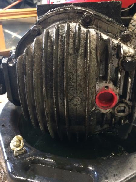

I have the Salibury differential and am in the process of making arrangements for it to be rebuilt and the gearing changed to 3.54. With that rear ratio I should be able to make some separation on long straights and the cobra should be able to out handle the mustangs, corvettes, jaguars and camaros that I will be primarily running against in the corners. The drain plug is drilled for the required safety wire.
Attached are some photos of the differential. As more parts arrive, I will provide more pictures and updates. Given the potential time frames that I am looking at for the roller, engine and transmission, I am hoping to have the car up and running for the SVRA vintage race at Mid Ohio in late June and then at the US Vintage Grand Prix a Watkins Glen in early September!
