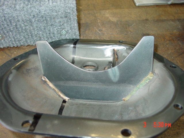

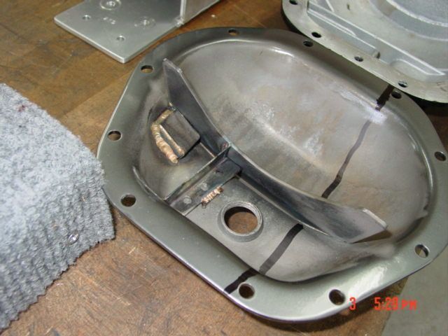

OK Jim
Here we go..... I'm only going to suggest things we did when we were racing against the A/P and B/P cars ... like you I didn't have all of the money, so I had to figure out how to do modifications on my own .... As luck would have it, we learned a lot and had much more confidence in the car when we got on the track. It is a great feeling when you win and have built or modified the vehicle you are driving.
Since you showed the Rear End.... here's some photo's of what you may want to consider ....
One of the problems we encountered was filling up our catch can on the rear end .... and we found out that the oil was going out the breather or vent hose into the catch can .... and then would not return to the diff.... then we would damage the differential.....
These are the mods we did to fix that issue...
These are the things we did to KMP259 as well and it has proven very successful.
Morris

Morris,
Thanks! Yes, like you, I will be doing most of the install and some fabrication. The hole that you covered with the small piece of metal in place, is that a vent hole?
I take it that the piece of metal that you installed acts like a windage tray and keeps the oil from splashing out of the top of the differential, right?
I am sending mine out to Drive Train Specialists in Warren, MI for new gearing, seals, etc. I all take a look at the differential when it returns and see what I can do that might be similar to yours.
